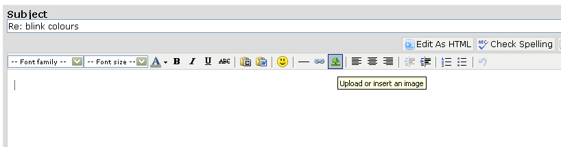

Use "upload/Insert an image" option that is there 3 times right to the smiley icon
