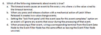

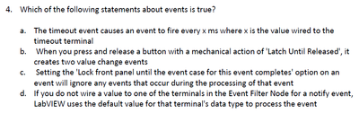

I came across the same question in two Sample Exams with different "correct" answers. These exams were downloaded from the NI's CLD-R Preparation Materials at
http://www.ni.com/gate/gb/GB_CUSTEDCLDREXAMPREP/US).
The first exam's question 6 has the "correct" answer as "D" in the Solutions page.
The second exam's question 4 has the "correct" answer as "B" in the Solutions page.
I am confused...to be honest, i think the correct answer is A!

Hi RagMan,
They are not the same question. For option (b) "latch when released" is not the same as "latch until released". For option (d) "filter event" is not the same as "notify event".
Definitely NOT A because it does not generate an event every X ms.  If another event is generated first, that timer resets.
