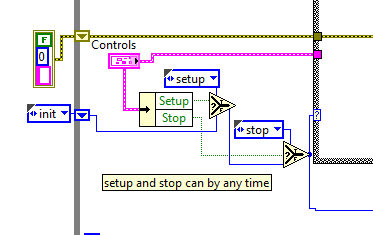

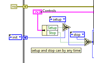

  • Wire bends.  wire bends.PNGbetter.PNGEnough said? Smiley Wink
