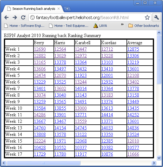

Created a website to easily share data with others.
Now that I've gathered, processed, and displayed data, its time to share it with the world. I've chosen to upload the html website generated last round to a server.

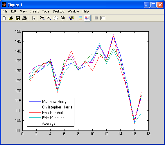

Are you a fantasy football enthusiast like me? Have you ever wondered what expert gives the best advice? I have, and I wanted to do something about it. With this code you can take a look at how each expert does on a weekly basis for the running back position. I used the ESPN.com website for the source data as its one of the more popular fantasy football sites around.

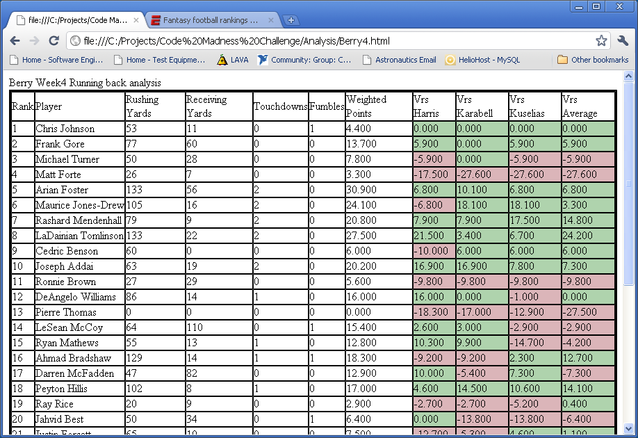

All the links can be followed. This will send you to the page below (different for each week/expert) and view a detailed breakdown.
I know this is not very complicated, but interfacing with MATLAB is one of the easyest things to do in Labview. This demonstrates the ease of passing data in and out of labview. This code runs very quickly, and there are a whole variety of interesting MATLAB graphs and data analysis tools that can be very helpful.
I have predownloaded all the websites for you. this should not mine through the internet unless you delete the include files, in that case it will download alot of data. This will greatly extend the time to create the html analysis site.

I used standard scoring for comparing the performance of each expert (6 pts/TD, 1 pt/10 rushing or receiving yards, -2 for fumbles lost)
The results are weighted in the following way
(Player scored points) x (50 - rank) where rank starts with 0. so there is a 50 point multiplier for the #1 ranked player each week, and a 40 point multiplier for the #10 player. I normalize the results so that they are near 100 (the typical total of a fantasy football week.)

I did not use any of NI's (or anyone else's for that matter) html generation tools.
I have written my own html scripter which is significantly more expandable (object inheiritance, tree structures) to allow for things like tables within tables, hyperlinks, images, and anything else that belongs in an html.
