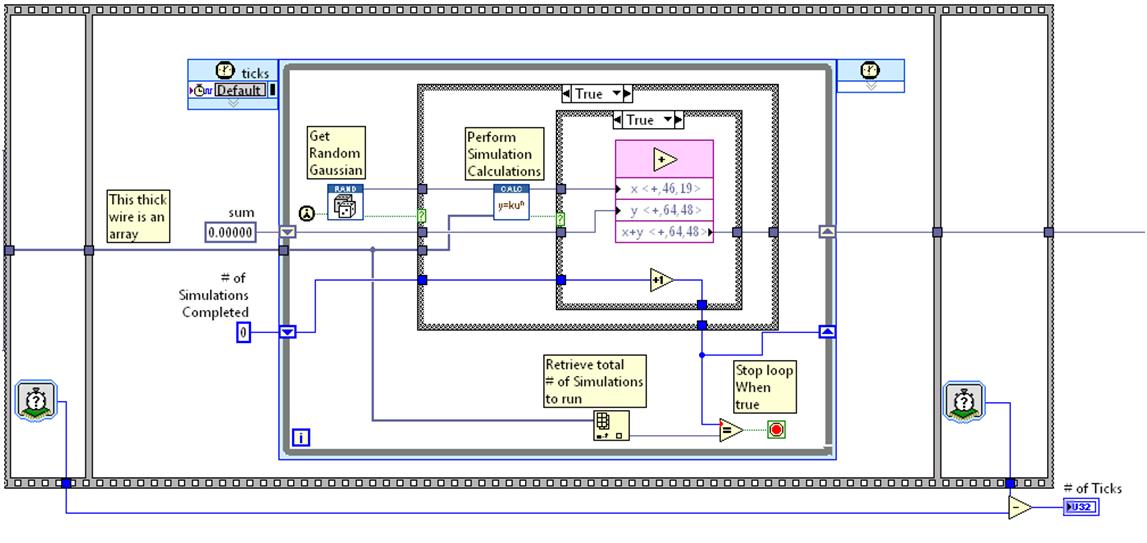

Here is a screen shot of the LabVIEW code that runs on an FPGA. The graphical code is simple and intuitive. (click on the image for a close up)
Here is a close-up of the Calculation VI. VI stands for Virtual Instrument, and is the LabVIEW equivalent of a function. Inside this VI is where most of the iteration calculations occur, notice the use of Fixed-Point Math.
After waiting 16 minutes and 55 seconds, the compilation completes and the compiler has reported to us that the maximum attainable clock rate is 80MHz, which at 1 simulation per clock tick gives us 80 million simulations per second, or 80 thousand simulations per millisecond. After reviewing the device utilization map, we see that this specific FPGA target can possibly fit up to ten copies of this algorithm. We copied the algorithm ten times on the chip and set it to compile. This time compilation took much longer, but it allowed us to fully utilize the Virtex-5 FPGA chip.
