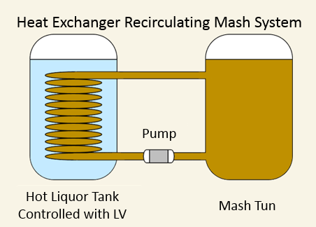

You're now expanding the project, what will that include?
Before introducing LabVIEW my system had one gas burner and a 50 litre vessel. I've now added the Arduino and have multiple 50 litre vessels plus all the electronics. This means I have loads to clean and sanitise to avoid contamination. My new build is going to be a RIMS (Recirculating Infusion Mash System) which only has one vessel again with a low wattage heating element to control the temperature. I'm currently waiting for some materials to build it. This time I'll be using LINX 3.0 with the BeagleBone.
