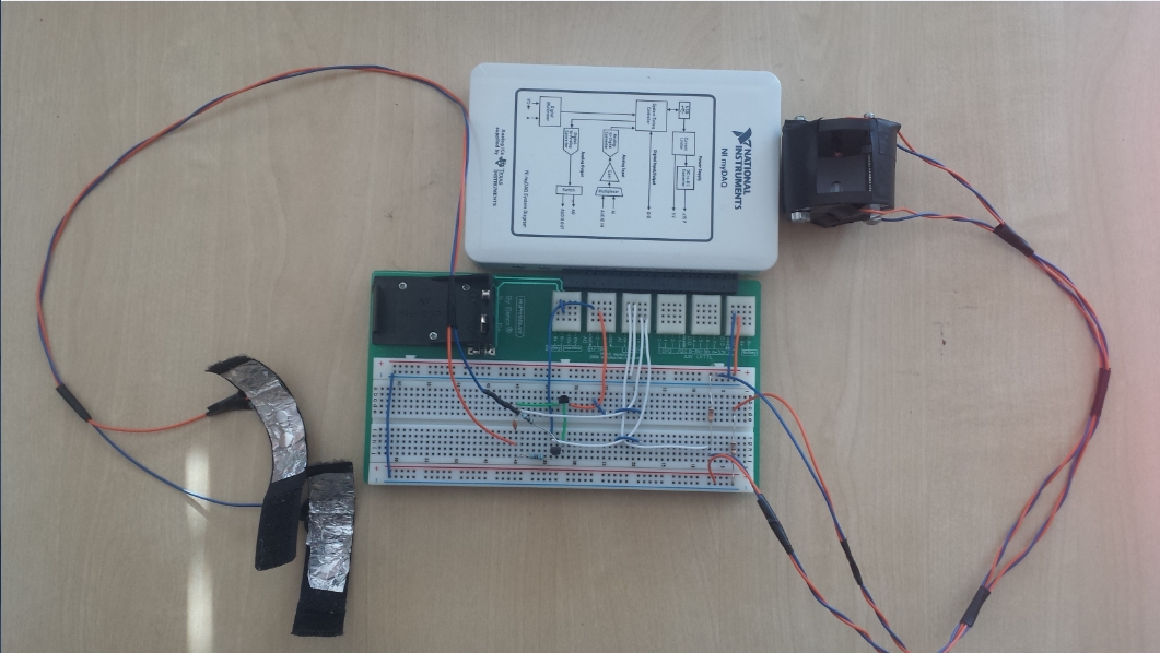

Figure1: NI's myDAQ connected up to the finger pads and Heart-Rate monitor
The "myLieDetector" measures and records several physiological indices such as blood pressure, pulse rate and skin conductivity, whilst a test subject is asked a series of questions. The subject's answers will produce physiological responses that can be differentiated when someone is lying or telling the truth.
The system utilises NI myDAQ to aquire signals from various biosensors, which are then analysed using LabVIEW to interpret and display the data. More specifically, the sensor data is processed to discern the heart-rate and perspiration of the human body.

The aim of the project was to build the system for as little money as possible in order to make it possible for anyone to build.
The main component of the project was the myDAQ - a compact, portable data acquisition system that allows users to measure and analyze signals anywhere, anytime. The myDAQ was combined with two sensing circuits, developed with the following componets:
You will also need some basic electrical cables and tools.
myLieDetector: Circuit Assembly
Sensing Circuit #1
The Heart-Rate monitor works by beaming light from an LED through the test subject's fingertip. A light detecting resistor (LDR) on the other side of finger monitors the drop in resistance each time the heart beats and sends blood round the body.
Sensing Circuit #2
The Perspiration monitor works by sending an electrical signal accross the skin of a test subject's finger. As a subject starts to feel anxious or guilty, they will begin to perspire. As this happens, the skin will be more conductive, creating a gradual drop in resistance.
Figure2: Heart-rate monitor Figure3: Perpiration monitor
Please see the detailed guide for more information and a desciption on how to create the finger pads and Heart-Rate monitor box.

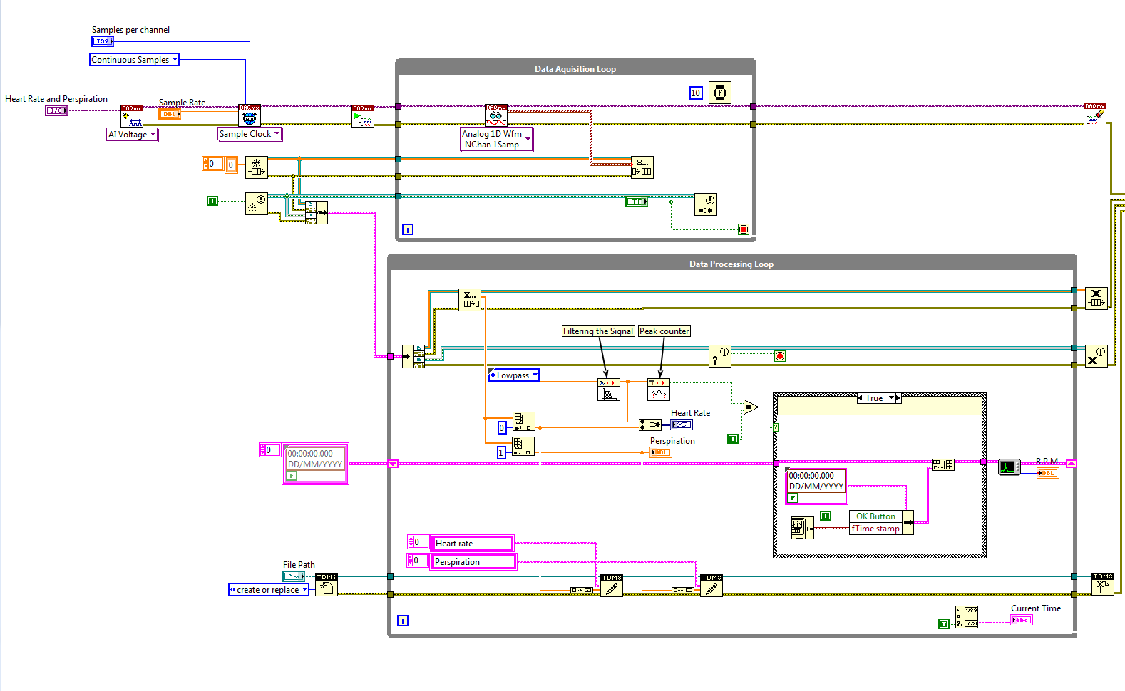

myLieDetector: The Code
You can download the myLieDetector, by downloading the zip file attached at the bottom of the page.

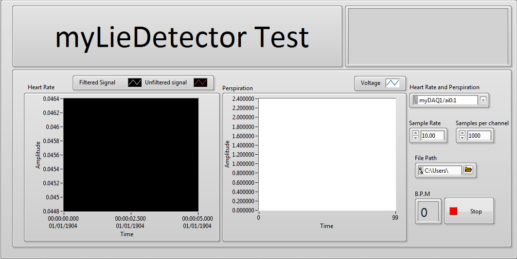

The code using the NI DAQmx driver API to set the data-acquisition parameters, before continiously streaming signals from the myDAQ over USB. Once the data is available in the software, simple processing begins. Data recieved from the Heart-Rate Monitor, is filtered to remove any noise. Peaks within the filtered signal are then counted up over extended periods in order to give accurate BPM. At the same time, changes in skin resistance
caused by perspiration are monitored.
Both the processed Heart-Rate and Perpiration signals are then logged to disk, enabling the data to be further reviewed incase the results of the test are inconclusive. I chose to use the tdms file to record my data, as it is capable of compact and fast data storage
Figure 4:Front Panel of the LieDetector
Figure5: Block Diagram of the LieDetector
