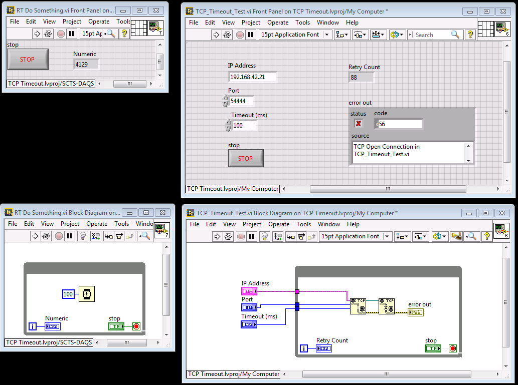

I had a moment to experiment with LabView 2015 here concerning the TCP connection issue to the CCC I was having.  Seems it's more fundamental than the CCC.
The "Stop waiting and disconnect" pop-up will appear in the most simple of situations.
  1. Create a project with My Computer and a RT target (I'm using a PXIe RT target).
  2. Add a client VI which simply attempts to connect to an unused or inactive port on the RT system in a loop (A retry loop simulation)
  3. Add a VI on the RT system which just shows a counter (Just gets the project to connect, deploy, and show some visible dev mode behavior) in a 100ms or so loop
  4. Set the retry timeout to 100ms and run it
  5. After a while, the project claims "Stop waiting for the target and disconnect".  The speed at which this happens seems dependent on how long the RT target has been running and how long the LV environment has been running on the host.
At this point, the RT target is in an unknown state (Most likely) and may need to be manually re-booted.  MAX seems to be able to talk to it at some level, but the project may not be able to reconnect).  labView.exe on the host may become unstable (I had to force terminate it).
Why there's any coupling between the TCP connections of the dev environment/RT target and the TCP errors from a running VI that can't connect to the RT target, I can't say.  But it shouldn't exist.  A TCP error in a user's VI should not be able to affect the ability for the dev system (Project) to maintain its connection to the RT target.  Is this a Windows thing or a LabView thing?

Thats great, I'm glad you identified that problem. I'm not really part of the standard support chain, so I'd strongly recommend contacting support@ni.com or your local phone support team and report the issue. Since you have reproducing code, it should go smoothly.
It seems like this is more or less the core of the issues you're seeing. Unfortunately there is no good way to know if the server is connected without just trying it. Since trying it causes a cpu issue, I think you need to contact standard support before you can reasonably continue (besides the workaround you mentioned).
