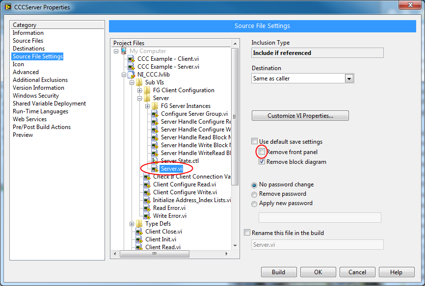

Can the CVT be used in .exe builds? When testing in LV the CVT works fine with my server & client VIs. However when building an .exe and running the start server gives an error code 2:
Invoke Node in NI_CCC.lvlib:Start Server.vi->Untitled 1.vi
Message 45 of 98
(14,711 Views)
This error is caused by the fact that Application Builder removes the front panels of all sub VIs when it does a build.  This is usually a good thing because it reduces the size of the built application, but the "Start Server" VI dynamically launches and sets the values of controls on the "Server" VI, which it cannot do when the VI's front panel has been removed.  The simplest way to fix this would be to go into your build settings and deselect the "Remove front panel" checkbox for Server.vi.  You'll first need to drag the NI_CCC.lvlib library out of the Dependencies tree in the project:
Message 46 of 98
(14,705 Views)
