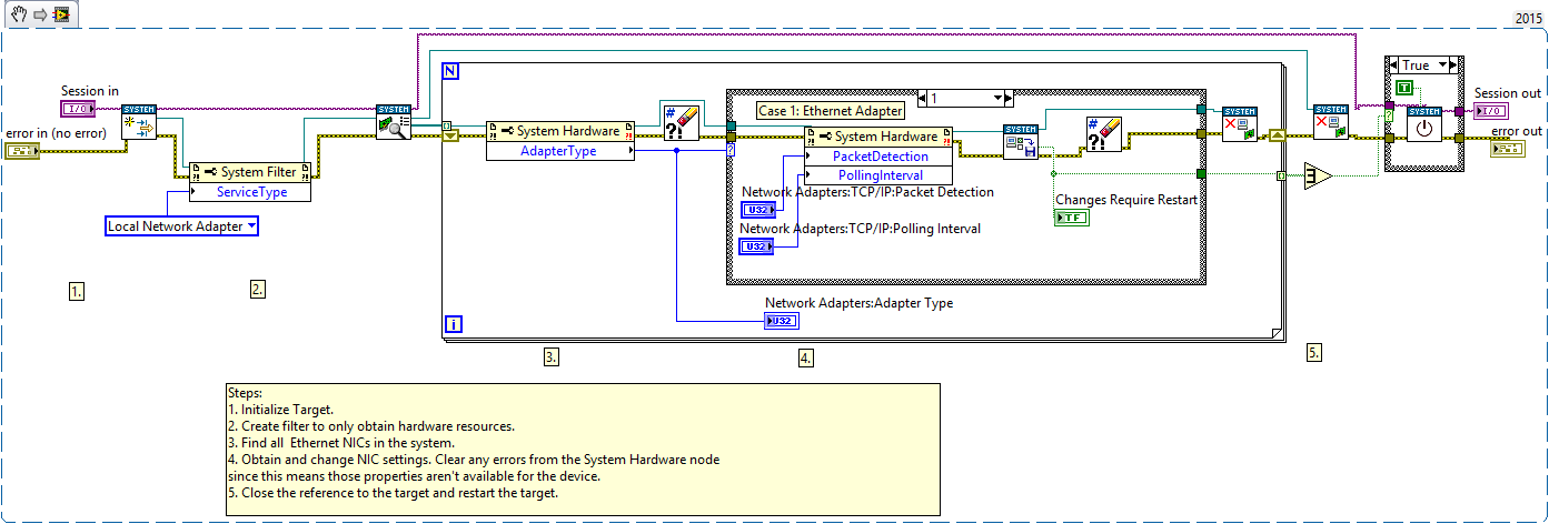

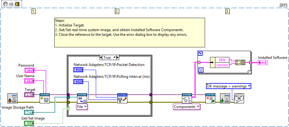

Hi Efthymiou,
I modified the Set Real-Time System Image shipping example to call the Packet Detection and Polling Interval properties after setting the system image. I was able to run the Set Real-Time System Image with Packet Detection VI on a cRIO-9074 and change the Packet Detection to polling. If you have an existing image, you can point the program at the image and set RT system images (you can also get a RT system image). This example doesn't implement the full features of RAD but would be a place to start using Packet Detection property.

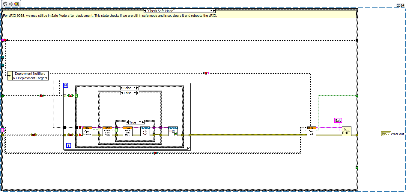

I made a change to my version that seems to work. I am sure there is a better way to do this, but it seems to work for me.
I added a state in rad_Deploy Images with Progress.vi called "Check Safe Mode"
For each RT Deployment Target, this state opens a session, checks if safe mode is asserted for the target. If safe mode is true, then clear the safe mode state (by doing the opposite of the force safe mode VI) reboot and then close the session.
This state is inserted before exit, which means "Apply Network Settings Check" and "Reboot No Wait" states go here instead of exit. The state then calls "Exit" next.
In the attached snippet, I created a couple of VIs. One checks for safe mode and the other clears safe mode.
