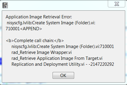

Hello I'm new using RAD, I'm getting the same error retrieving the image of a crio. What would it be a 100% full file system? How can I fix it? could you share the link to the issue at github? Thanks!!!

This is the error reported in my case. I hope you can help me.

Your main clue here is that the error happened in the Create System Image (Folder).vi.
An obvious thing to check is if you have write permission on the directory in question. Or in this case if there is enough space on the target file system to hold the image.
First to see where images are being written, select the "Settings" on the right hand side. This will show a pop-up with the current directory where image files are written. Do you have permission to write there? Is there enough space?
If that isn't it, I suggest getting the source and trying to debug it.

Hello, thanks for the fast answer. I don't think this is my case:
Do you have more ideas?

Hi Roger,
Your error isn't about the space on the cRIO. It is about creating the image on the computer. RAD is failing to make the image folder on the Windows 10 PC for some reason.

Hello I followed your suggestion and found this while debugging I think the error still in the cRIO.
Do you have idea of what is happening?
