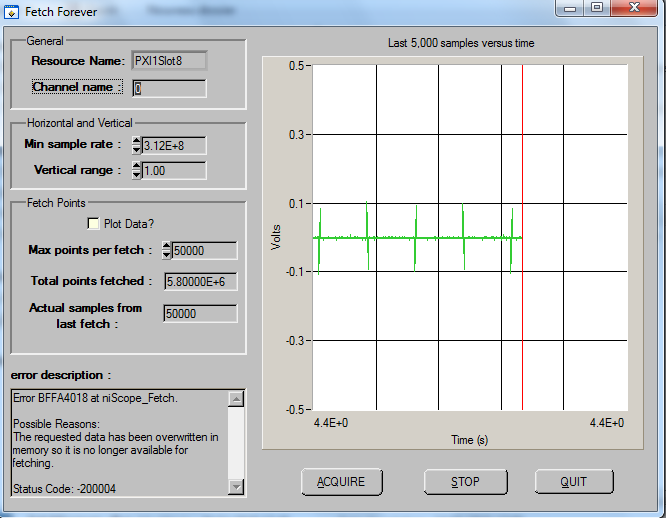

I am very interested with this example. i will have to adapt it. But i don't understand how it is possible to reach 600Ms/s after my tests.
When i tested 2 examples from NI "Fetchforever" (5.8e6 fetched point instead of 1.2G that is the memory of the 5185 card) and  "Multi Record Fetch More Than Available Memory", at 312Ms/s, it seems that speed fetch is too low to follow records acquired.
Ideally for my application I would like to set up a continuous multi-record acquisition on the PXIe-5185 using external trigger. In other words, its an infinate record acquisition.
For example: I would acquire 4096 samples (this is record length) at about 4 KHz at 312.5 Ms/s sampling rate. This would go on and on using the "more than available memory option" so as to keep overwriting the memory cyclically.
So i will have to adapt this example, but i don't understand why the exemples does not work at 300Ms/s...! I started to code it but i have the same probleme : after 500 000 records, acquired records not fetched are more than 100 000. I tried with the external PC and it is the same problem than with the 8135 controller.
How is it possible to do streaming at 600Ms/s if at 300Ms/s, fetched record speed is too low !? At a moment, with this "fetch" speed, the memory is full and data are overwritten with an error or the 100 000 records not fetched are reached.
