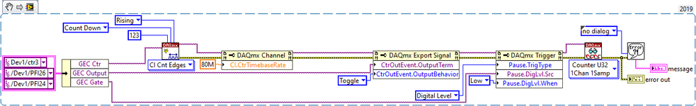

My understanding is that the "internal max timebase" will be 80M, which is then set as the "source selection".
Based on this post, I tried:
(Oops, I just now realized that these snippets left out the "Start", but the read autostarts, so it returns the same error.  This was a test VI that I derived from my actual code.)
This returns an error:
Error -200452 occurred at Property Node DAQmx Channel (arg 1) in Test GEC.vi Possible reason(s): Specified property is not supported by the device or is not applicable to the task. Property: CI.CtrTimebaseRate Channel Name: Dev1/ctr3 Task Name: _unnamedTask<52>

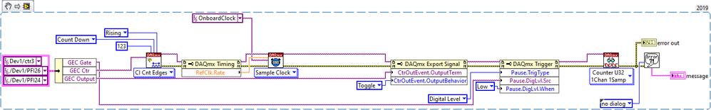

Calling the DAQmx Timing VI, which returns a similar error:
Error -200303 occurred at Test GEC.vi Possible reason(s): External sample clock source must be specified for this application. Unspecified Property: SampClk.Src Channel Name: Dev1/ctr3 Task Name: _unnamedTask<53>

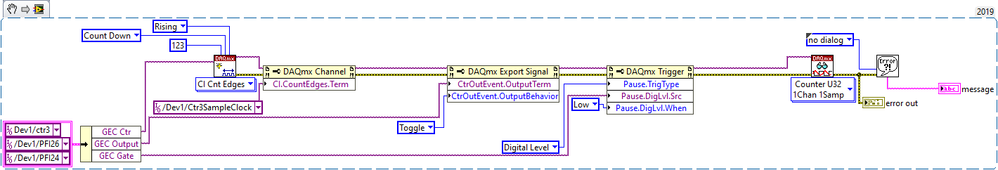

And also trying to use the CountEdges terminal to /Dev1/Ctr3SampleClock, which returns the error
Error -89136 occurred at Test GEC.vi Possible reason(s): Specified route cannot be satisfied, because the hardware does not support it. Property: CI.CountEdges.Term Property: CI.CountEdges.ActiveEdge Source Device: Dev1 Source Terminal: Ctr3SampleClock Task Name: _unnamedTask<55>
