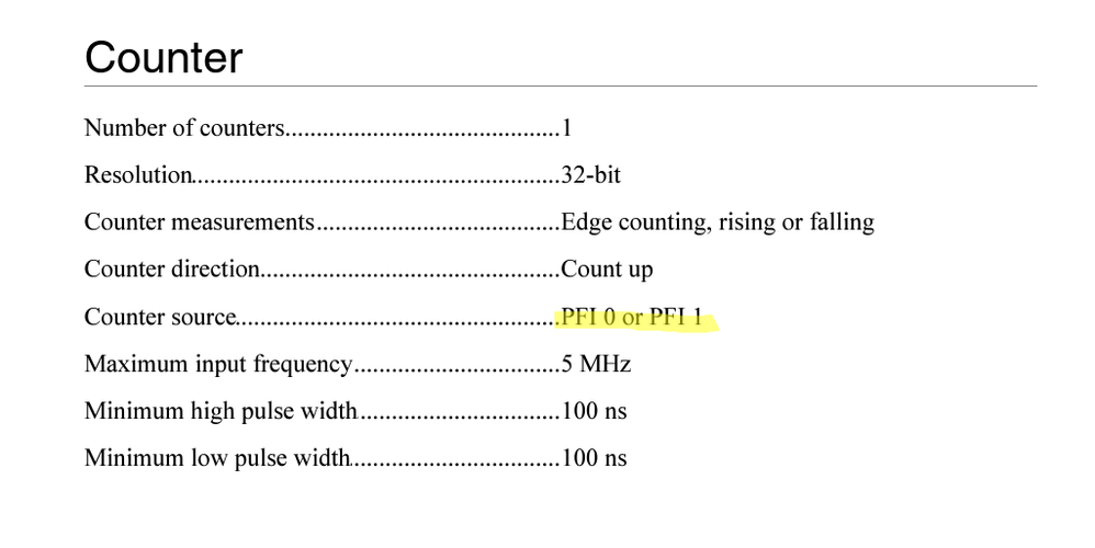

You have to use the counter resource on PFI0/1 to count the pulses from your energy meter.

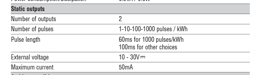

Not easy though, below are the issues,
  • USB 6001 inputs are only 5V tolerant
  • Your energy meter has two outputs, but they require 10-30V for operation
Do you have an external 12V DC supply that you can use here and a bunch of resistors?

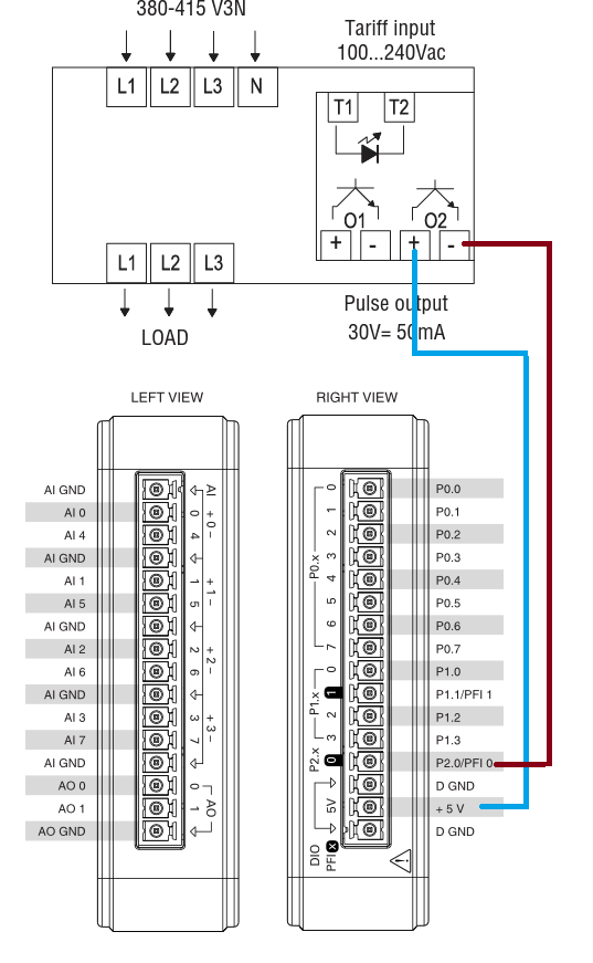

Your device states 10-30V for operation but worth a try for the below connection

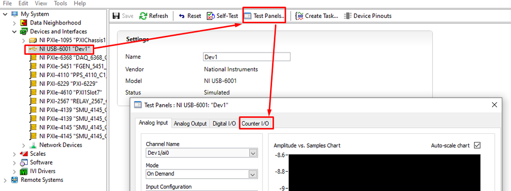

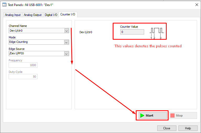

Using the output in PNP configuration, use NI MAX test panel to monitor pulse count,

Thank you, you are very kind. I will try this setup by running the 5V energy meter. If this does not work, an external power supply with resistors must be provided. I ask you the kindness to post the scheme of this solution as well. Thanks
