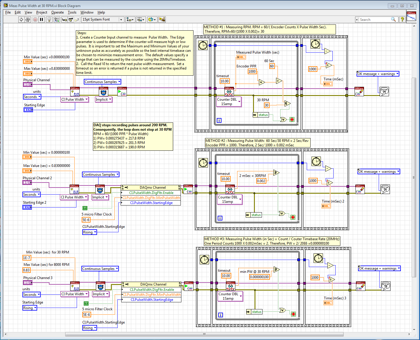

My objective is to stop updating data logging pulse width measurements at 30 RPM so I can record the time lenght it takes the RPMs to stop from 6000 to 30 RPM. When I turn off the tool. I have an encoder attached to an output shat of a 6000 RPM circular saw. I have created 3 program methods, but I was not able to stop at 30 RPM. The last pulse width value the data log updates is around 200 RPM. I don't know if I'm using the right method to read RPMs?

In method 1: I reading pulse width and converted to RPM with this formula. RPM = 60/(1000 PPR/ Pulse Width).
In method 2: I just measuring pulse width and try to stop while loop when pulse width value is greater than 0.002 mSec. by using this formula 60sec/30rpm = 2 sec/rev, 1 Rev = 1000 counts. Therefore,     2 Sec / 1000 Counts = 2 mSec/Cnt (0.002)
In method 3: I measuring pulse width using this formula,                                                                   Pulse Width (in Sec) = Count/Counter Timebase Rate (20MHz), One period is 1000 cnts X 0.002mSec = 2. Therefore, Pulse Width = 2 / 20MGz = 0.000000100
All three methods stop recording pulses around 200 rpm. I wonder if the formulas I utilizing, are not using them properly. Or there is floating point number conversion???? Please See attached Picture.

Charles_DeJesus,
Could you check the output waveform of the encoder? Do you see spikes? Sometimes spikes might produce wrong counts.
