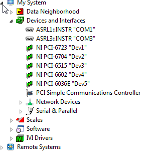

I am working on setting up our NI PCI 6602 to generate a PWM signal. I have used the suggested progamming from https://knowledge.ni.com/KnowledgeArticleDetails?id=kA03q000000x1P0CAI&l=en-US.
When I try to setupo the Counter I/O input to the DAQmx Create Virtual Channel.vi, it will not configure for a Cntr out for the 6602. It will only let me configure the AI channels of the 6036E card. What am I missing?
Sorry for stupid questions. I am new at this.
2016-08-09 10_37_10-NI PCI-6036E _Dev5_ - Measurement & Automation Explorer.png

Did you change the DAQmx Create Virtual Channel.vi instance to CO Pulse Freq?
