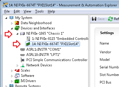

2. When the PXIe-6674T fails to route to PXI_Clk10_In, does the PXIe-6674T show up under the chassis in MAX (see example below)?
-Tyler
(7,591 Views)
The NI-Sync is version 3.4.0 and when it fails it does show up in MAX.
