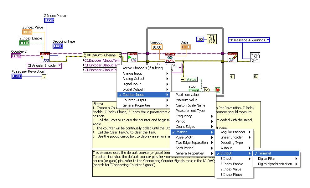

It is possible to assign the counter terminals to different lines. To do this, right click on your block diagram, then select and place Measurement I/O » NI-DAQmx » Channel Node. Place the channel node before the DAQmx Start Task.vi and wire the task and error terminals appropriately. Then left click on the channel node and select Counter Input » Position » B Input » Terminal. This is shown in the picture below. Change the terminal to be writable by right clicking on the channel node and selecting Change All To Write. Finally, create a terminal constant by right clicking on the input terminal to the CI.Encoder.BInputTerm property and selecting Create » Constant, then select choose one of the available PFI lines from the drop down list. This process can be used to change any of the counter terminals.

It sounds like the channel node is not getting executed every time the task runs, since you say that it routes inconsistently. Is your channel node executing every time you run your task? Is it in a case statement or any other control structure? If you can, please post a screen shot of your code. Doing this will let me see exactly how you’ve configured the counter and will help me better understand why the signal is not routing correctly.

Here is my code in the attachment (Encoder Pic.jpg)
Sincerely, Yours
Jaewon Choi.

The picture quality is not so good.
I attach the original file.
