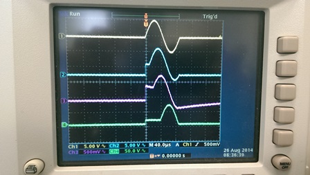

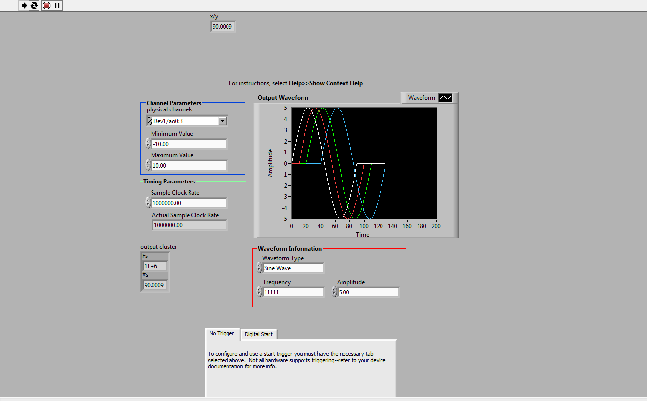

Hello David,
Thankl you very much for your reply.
As per you advice I changed my samples per channel to 90 samples.
I did that by decreasing my Frequency to 11.11K.
My oscilloscope outputs look better than before but not exactly the single pulse sine wave.
The channel one is sine pulse.
The rest of the channels are not.
Please help.

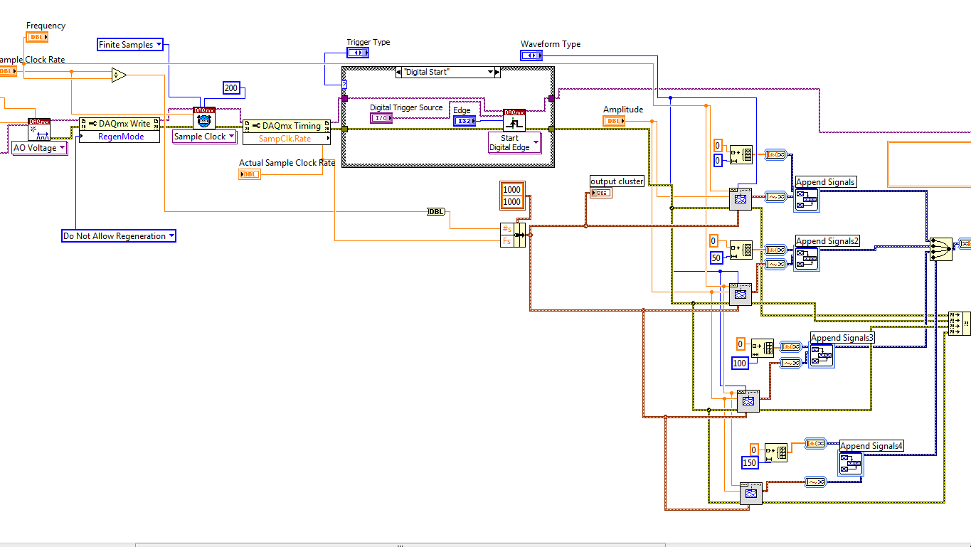

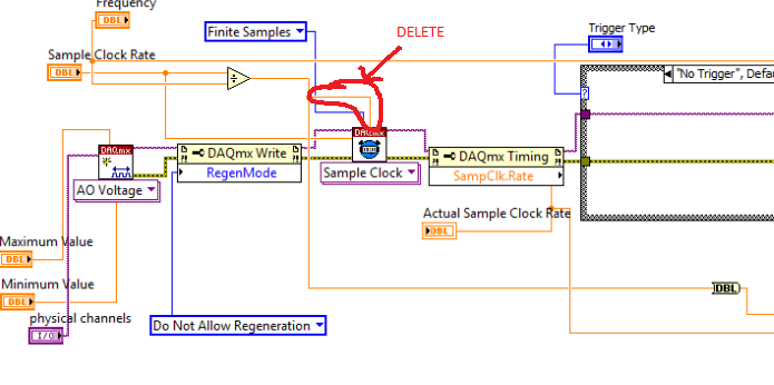

Hi Puspa,
I'm sorry if I didn't make myself clear.  You CANNOT resolve this issue by changing your frequency.  The number of samples you write to your "Samples per channel" terminal on your DAQmx timing VI needs to equal the sum of "#s" and the longest array of zeroes. In other words, your "Samples per channel"  CANNOT be equal to "#s" as is currently the case in your code.  This additive relationship must hold true regardless of your frequency.
1.  Change your frequency back to whatever it was before you changed it to 11.11k.
2.  Delete the small orange jumper wire circled below that currently feeds into your "Samples per channel" terminal.
3.  Wire in a constant to your "Samples per channel" terminal that is equal to the sum of "#s" and your longest array of zeroes.  If "#s"=50 once your change your frequency back and your longest array still equals 40, wire in a constant of 90.  Do not change any other parameters.

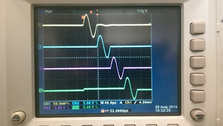

Hello David,
Thank you very much for your reply.
You were very clear in your explanation the first time, My apologies I could not understand better. This time I made change in my sample not in my frequency Smiley Happy and the output is perfect. The four single sine pulse from four channels. Picture attached.
