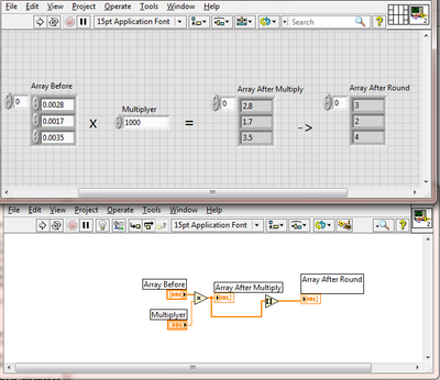

Hey dav2010,
Below is a screenshot of a small example of how to multiply all values in an array by 1000 and then round them to the nearest integer. I'm not sure if this is exactly what you are looking for, but I hope it leads you in the right direction. If this isn't what you were looking for, could you post a screenshot of what you are trying?
Travis Ann
