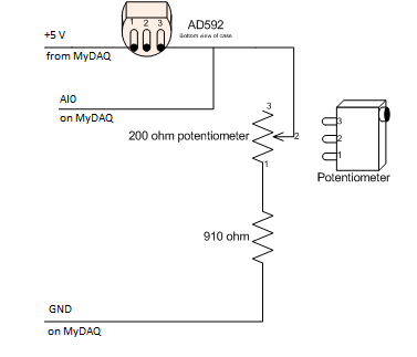

Create the circuit shown in the following diagram using your MyDAQ, solder-less breadboard, one AD592, one 910 ohm resistor and one 200 ohm potentiometer. This will connect the AD592 as a single ended input to your data acquisition card. Use the components from your kit, and the wires from the network cable as hookup wire for your connections.

Execute the program in continuous mode. Notice that the numbers and the chart are slightly unstable, indicating that there is electrical noise on the extremely small signal. Using the chart, try to adjust the mean voltage by using the potentiometer so that value is according to the following formula:
0.272 Volts + (.001Volt * Current room temp in deg C)
The hardware should now be calibrated for the current room temperature.
