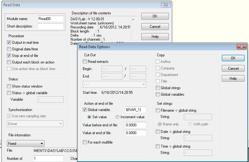

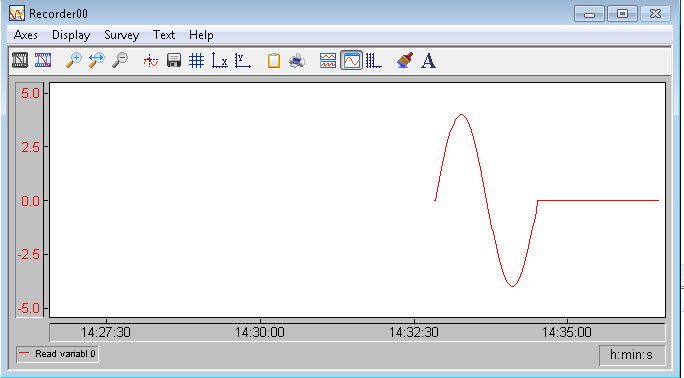

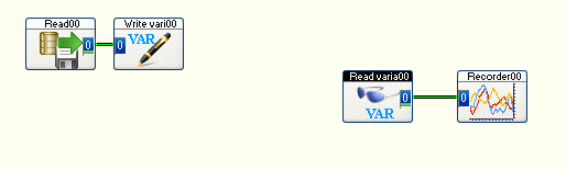

Try this - split the Read function into two, so that they're completely disconnected. The Read variable module should use the same timebase as the original data.
Then, set the Option to zero the same variable at end of file.
