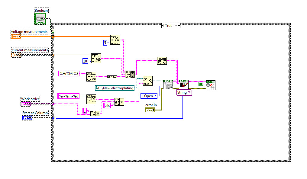

I like to add my measurement data to one Excel file. I used the ppend data finction but it still overwrites on the same row. my data is coming from separate subvi continiouslu and have different length. I separated each set of data by writing it on different columns.Append Data.PNG

it's a silly bug that will be fixed in V 2.1.
Please, instead of "Append Area" use "Get Last Row", Increment the value and "Write Area" for now.
Also, judging from the icons you are using an older version of XLR8. Feel free to download the most recent version 2.0.1.3 from the LabVIEW Tools Network!
Sorry for the inconvenience and thanks for trying out XLR8!

Just start your VI Package Manager, browse to XLR8, right click an select "Install Other Version":
Jens
EDIT: Or use the direct download link from the link you have provided. Version 2.0.1.3 is online and available. This version will include "Last row" at "Edit Sheet" ->  "Utilities"...
