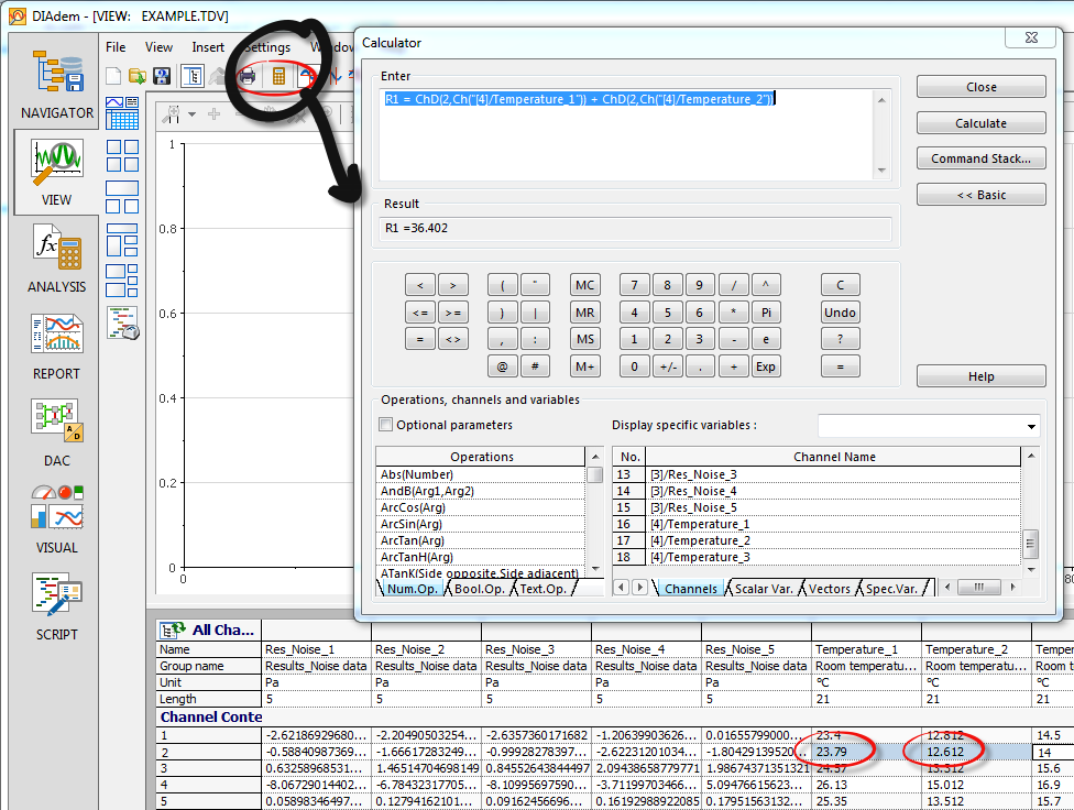

Hello Shannon,
It sounds to me like you would like to add two or more "cells" (to use Excel lingo) together.
DIAdem manages data as channels, not individual cells. So the approach to add two cells in DIAdem works like this:
The ChD variable allows you to access a single "cell" in a channel, using the following sequence or parameters:
ChD(X,Y)
where X is the row number of the channel table, and Y is the channel (column) name or number of the cell you wish to access.
So, this expression here calculates the result of adding the 2nd row value of the channel called "Temperature_1" and the channel called "Temperature_2" from the example data set that loads when DIAdem is started. R1 in this case is an internal DIAdem real variable that stores a single value.
R1 = ChD(2,Ch("[4]/Temperature_1")) + ChD(2,Ch("[4]/Temperature_2"))
The calculation above can be entered in the "Calculator" which is available in DIAdem VIEW and in DIAdem ANALYSIS in the toolbar.
I hope this is helpful, please let us know if you have additional questions,
     Otmar

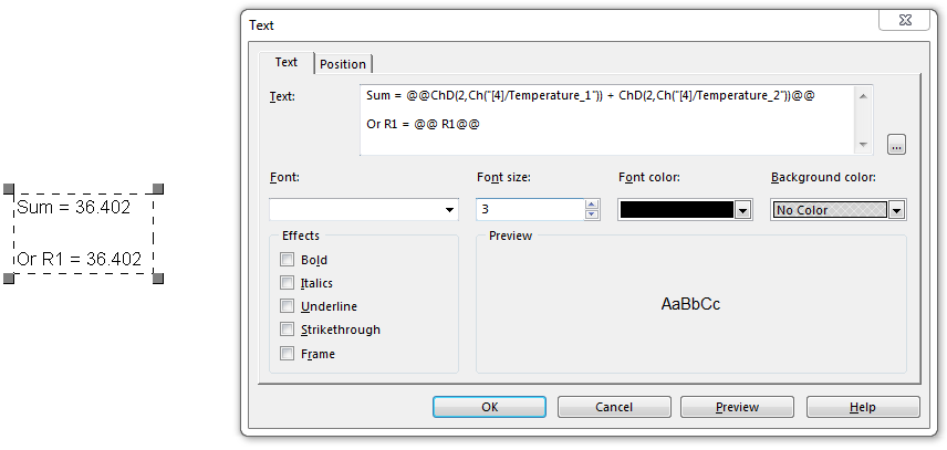

Thank you Otmar...this is most helpful!!
Now, my question is... how do I get my 'R' values onto my reports?  I'm having trouble figuring out how to do that.
Thank you!

Hello Shannon,
There are multiple ways to do that, including putting the results of your calculations into a new channel (for a table for instance), or simply by putting the calculation or the variable reference into a text, see these two attached examples (they are both in the same text window):
As you can see, you can even do the calculation right inside the text, or just reference the variable containing your results.
The @@ tells DIAdem that you are referencing a variable (or variables in the first case) and want to see the contents of these variable(s).
If you have an example of what your final goal is for a report (i.e. a table of values, a constant line in an axis system at a specific value, etc.) I can create a more specific example, but this is the general way how you can include calculated values and variables inside a report.
     Otmar
