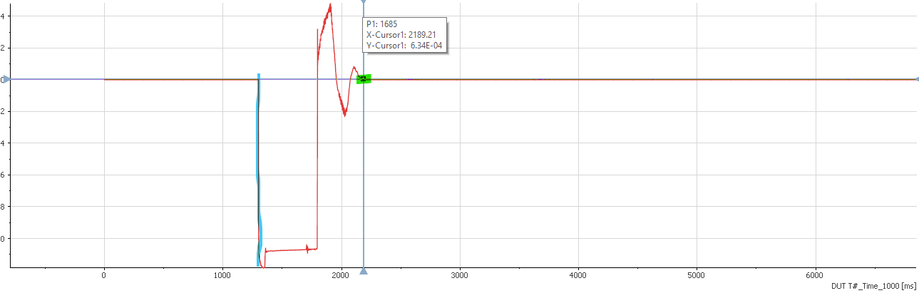

For example, here is the graph I am trying to analyze:
PeytonS_2-1707328433355.pngPeytonS_2-1707328433355.png y-axis = Voltage
The blue highlighted line is the first trigger that is being properly identified, and the second trigger I am trying to locate is in green, where the voltage goes back to 0.
The first trigger was located properly at 1300 ms, so with the specified range DIAdem should only be looking for instances of this specified change from 1800-2300ms. When reading the first instance of this trigger returned from this function, I am reading two problems:

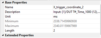

2. The two points of time that are returned are 2338 ms and 2340 ms, which are incorrect (as the graph shows this should be at ~2190 ms) and are outside of the specified range.
