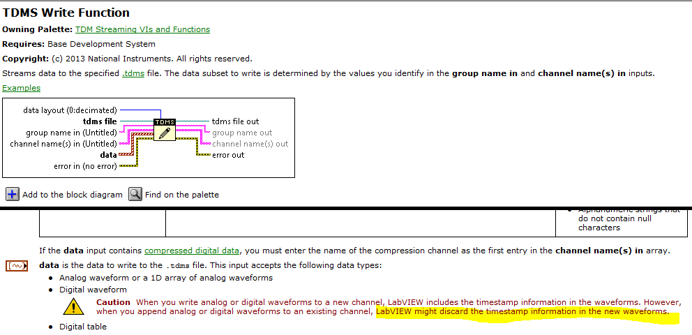

OK, so NOW he reads the help file:
I wonder why it says "MIGHT".  Does it decide on a whim to discard or not ?  Maybe it does it if the user is STEVE, but not for JOE?
I wonder why it doesn't include the "dT" part - it seems like it always discards that for subsequent waveforms as well.
I'm not NI, but I can think of a reason why it might not discard it.  Lets say I wrote to a channel an array of doubles.  Then I write to that same channel a waveform.  In this case it won't discard the start and dt information because it has never been writen as a property before.  I think a more clear explaination is it will write the start and dt time from a waveform, if one has not been written to that channel yet.  If it has it will discard this information and keept he t0 and dt information that is already associated with that channel.
Each channel has have, at most, one dt and one t0, just like a scalar waveform.

Hi Steve,
Wow, that LabVIEW Help content is odd, and I agree with your complaints.  The dt is ignored as well and so is the offset-- only the first start time and offset and dt are recorded, but for each subsequent buffer write to the same channel, all those properties are never written again, to my knowledge.
The only way to plot vs. a datetime X axis in DIAdem is to use a datetime X channel.  When you plot a waverform vs. a numeric or datetime X channel, all waveform properties are ignored.  That means that you need to transfer all the waveform properties to the datetime channel you use as your X channel.  The "Numeric Channels <=> Waveform Channels" function in the ANLYSIS panel does this for you when you select the "Absolute time reference" radio button at the bottom.
Yes, you have to go through all these steps in DIAdem to see what you want.  In fact, if each of your channels can start at an individual datetime, then you could in principle need a datetime channel for every data channel, even if all the data channels had the same sampling period.  I continue to offer my assistance in automating these steps with a script, once you have decided how to store all the data acquisition information you need in your TDMS file.  If you decide to pad inactive periods with NaN values, or if you decide to store a time channel for each data channel in TDMS, then DIAdem will graph that data easily.  If you decide to store multiple waveform buffer channels for each physical channel, then we'll need to stitch those together afterwards or graph them in the same color.
