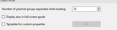

Now, we found a temporary "trick": in DIAdem general settings, you can increase the number of expanded groups when loading, for example up to 25:
In that case, and assuming your dataset has 25 groups or less, the groups will all be expanded when loading the dataset, and they will remain expanded when using the group/channel filter:
That being said, if after loading the data, you manually collapse all groups (which we typically do), the annoying behavior comes back...
