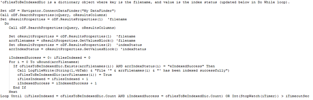

I want to be able to determine in a script when a set of files have been either indexed for the first time (new files added to My DataFinder), or when they have been updated (new properties, revised property values).  The function I have now uses the DIAdem extended file property "indexStatus", but it doesn't work in all scenarios. I cannot provide code example because I get Blocked by NI.
Does a better and more robust method exist?

To clarify, my interest is to know when (by using a script) the indexing of a set of files has been completed.  The set of files may be new files added to the DataFinder search area, or existing files that have had their file properties modified.   I want to be sure the indexing is complete so I can generate (by script) a new Navigator search that will reference some of the new file properties in the files.  If indexing is not complete, the search results will be incomplete.

Have you ever worked with job file indexing in the DataFinder?  I don't know what polling/notification options exist for that approach, but at leas each collection of files is clearly defined in a file that the DataFinder knows when it's done with.
