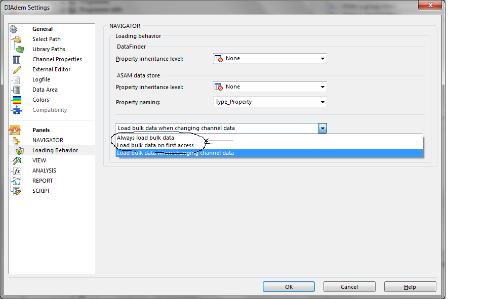

It might speed up if you change the loading behavior if your files are fragmented.
Please have a try.

I tried your suggestion (Load data on first access), but it does not help. I think it only applies for reading data from storage - that may be a good optimization, but I have the problem in the report tab where data probably are in memory already. It is painstaking to edit the report - whatever little action on the report layout may take half a minute. Almost useles to work with.

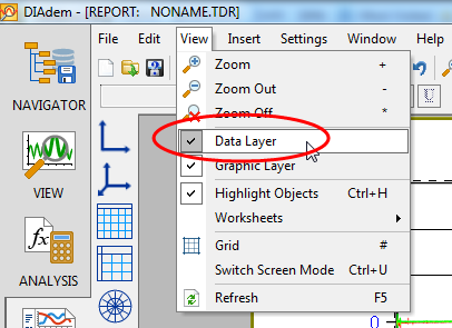

If you are editing parts of the REPORT that are not benefiting from actually seeing the data (like adding or rearranging text or other items), you can turn off the data layer in this menu:
That will show all the axis systems with no data inside, good for making edits that do not require you to see the data in the axes.

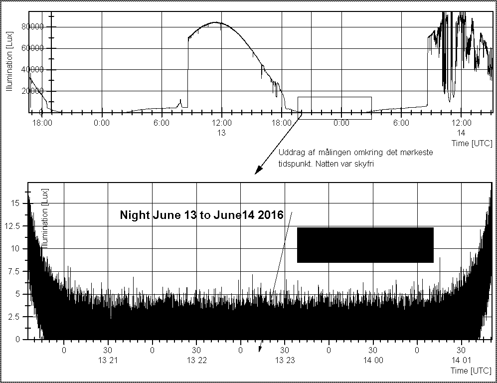

I would still like to know what causes the issues with the redraw speed though. Can you post an image of the report you are creating (please remove any confidential items from the report before posting it here). We may be able to narrow down the issue by looking at the type of report you are trying to generate ...

The plots are simple 2D plots (amplitude versus time) looking like this:Report page.PNG
The time axis holds 3M points.

> The data are on a networkshare
I really believe it is related to the Load Mode of the Data.
Please set it to
  • Load Bulk on first access
  • Always load bulk
And make sure you reload your file before testing. (It is just changing the behavior for the future)
You have to save your Desktop.ddd to make the setting persitent.
P.S.: If set to "Always lod bulk" it is made sure that all data is cached before you start reporting at all. So you will see the Impact of Report without having to move data from share to local memory.
