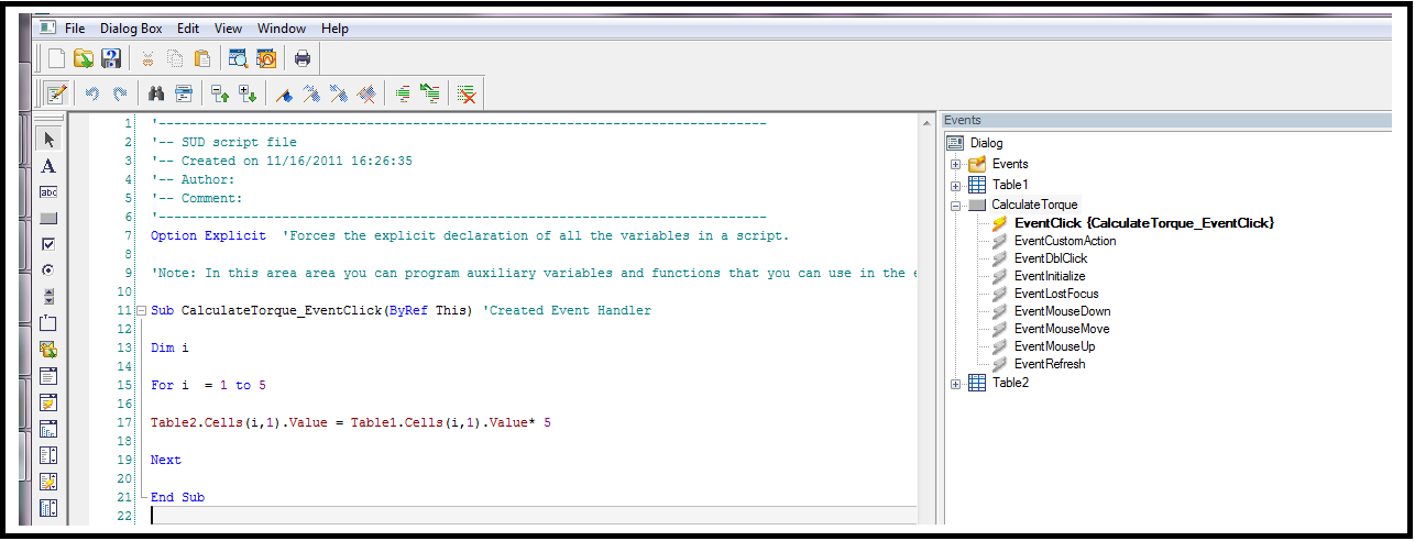

Hi smoothdurban,
Here is a quick example of the beginning of what you want to do. It gets data fromthe table modifies it and puts it into another table:
I hope that this helps.
Perry S.
Applications Engineer
