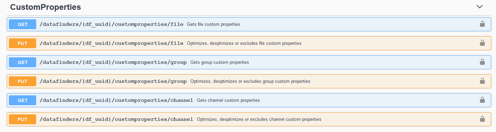

The Navigator object's methods now only work for the "My DataFinder" that ships with DIAdem.  Since the TDM Server (now SystemLink TDM), the only way to programmatically change the DataFinder's settings is to issue web service commands, which DIAdem can do with native VBScript or Python commands.  There are no dedicated commands in DIAdem to do this.  Here's an excerpt from the Swagger documentation of the web service API to configure the DataFinder:
