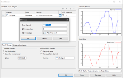

Hello warburtoni,
I think you can use the Channel Event Functions for this. The first step is to find all values where the difference is zero. In the second step all results with more than 10 hits are filtered. The third step is to create a result channel.
ChnEventList1 = ChnEventDetectionDifference("", "[1]/Signal", 0, "absolute-exact")
'Call ChnEventCreateFilteredFalseChn("/EventStatus1", ChnEventList1, "[1]/Signal", NOVALUE) ' for test only
ChnEventList2 = ChnEventFilter(ChnEventList1, "Peaks", 10 , "Index")
Call ChnEventCreateFilteredFalseChn("/EventStatus2", ChnEventList2, "[1]/Signal", NOVALUE)
Greetings
Walter
