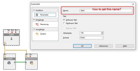

Is there any way to get the name of a DAC block in script based on its number?
Background: I want to get the name of the system clock block that provides the system clock signal to another block.
To my knowledge there's only a variable that provides a block number of the system clock block (not its name).
Example:
'open any bock that has a system clock signal connected to its system input
Call DACObjOpen("Speichern1")
    'get the number of the block that provides the clock signal to the previously opened block:
    ClockSignalBlockNumber = BlSysSourceBl(1,1)
    ClockSignalBlockName = ??? 'how can I get the name of the clock signal block ("Takt1") now based on its number?
Call DACObjClose("Speichern1")
Best regards
Christian
