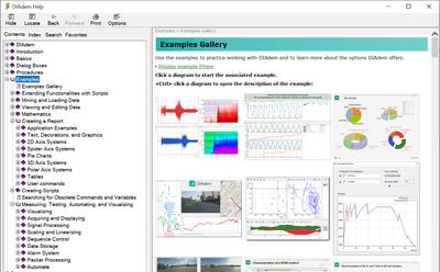

The help included in DIAdem contains numerous programming examples, which are sorted by topic. You can also use the example gallery to run examples directly. The help pages provided on the web are outdated and incomplete as there are no links to the sample files. The sample files are installed with DIAdem. There are VBScripts and Python scripts.
