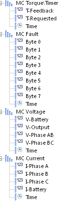

I'm trying to create a user command script to automatically set the X-Axis of a Curve when a channel is dropped onto a 2D Axis System. All of our channels are in groups and each group has it's own time channel:
Since they are consistently named, it would be really nice to be able to set the X-Axis with a User Command. I have the basic template below (I'm new to DiAdem) but I don't know what methods to use to finish it.
