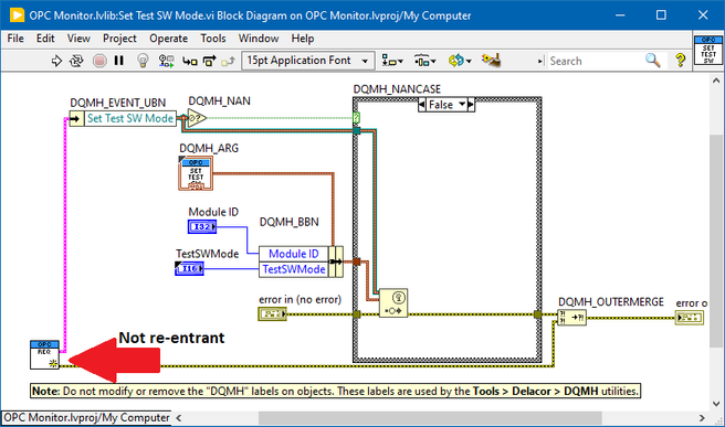

As an aside, the DQMH API request VIs are reentrant, but Obtain Request Events.vi are not. I think I need to review my reentrancy knowledge, but if the calling VI is reentrant, does this automatically make the sub-VI reentrant as well?

SubVIs of a reentrant VI are not made reentrant.
You can check if this is your problem by modifying your vi to use a feedback node to cache the User Event that it is getting from that non-reentrant SubVI (since I don't think it ever changes).

Indeed reentrancy do not apply to subVIs.
All the subVIs within a VI must be re-entrant to achieve a 'real' reentrancy.
The VI you can from TS is a request which is re-entrant and only contains primitives and re-entrant VIs.
The VI you pointed out of played only once per module life cycle. So I'm doubting this one is the problem.
If I remember well, with shared reentrancy LV creates a pool of VIs that will be launched one after the other upon request. When the end of the pool is reached, it must reallocate memory to extend the pool for new callers. When a caller ID stopped, it lets an empty space in the pool which then can be taken by a new instance. Not sure about that, but I've got in a corner of my head that the pool is set to 4 instances (each time you call a re-entrant VI and the pool is full, LV reallocates 4 new memory spaces in the pool).
You're definitely overpassing that number. May it takes time to run the allocation mechanism in a row?
Have you tried changing the reentrancy of the VI to have is own memory space (preallocate ; must be applied to all subVIs) ?
