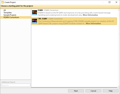

This application sounds similar to the Continuous Measurement and Logging Sample project that comes out of the box with DQMH. Have you tried this out yet?
Fabiola demos it here: https://youtu.be/4iRpki7G8xQ

CML based on DQMH® framework (wovalab.gitlab.io)
delacor.com/documentation/dqmh/DQMHDocumentation.html#DQMHCMLSampleProject
The updated, current URL of the DQMH documentation is documentation.dqmh.org, so the correct deep link is
https://documentation.dqmh.org/DQMHCMLSampleProject.html
