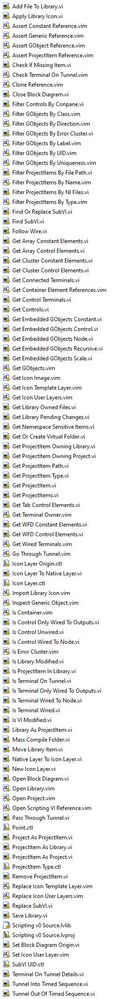

When maintaining and automating tasks around the physical files (there are dozens of use cases I could mention from refactoring to SCC), I really prefer the first of these two views of a library (and this isn't the biggest library we have, some have +300 files in their debug/dev configuration, this is just 100 files):

@SteenSchmidt  escreveu:

For me it comes down to helping the developer. There are operations that are probably best done with the file explorer as starting point, rather than the library: Moving a coherent chunk of files out of the library (all "GObject" related stuff for instance, well, that's found in the "GObject" folder). It could be SCC tagging or locking. It could be batch modification (callers, icons, descriptions etc.). But also mental mapping of the code for me begins on the disk.
In all honesty, it is rarely a problem for me with keeping a like hierarchy on disk and in the library, if that's the best. But it has often seemed unmanagable when I inherit code that is just in one flat folder. I also see other devs struggle with it, typically experienced by orphaned files in that flat folder which the original dev didn't notice, because they always looked at their code through their library. It might be a ways-of-workings thing, where one way fits your workflow best, and another way fits my workflow best. It could be interesting to get deeper into the "why" of these habits 🙂
300+ files seems a lot for a library with one scope.
Oh, totally. 300 is an outlier. I just went through a couple of typical libraries here: 6, 36, 46, 58, 88, and 94 files. And I wrote "in their debug/dev configuration". Our libraries have all source code in them, including unit tests and utilities only meant for the IDE (help menu, tools menu, probes, quickdrop and so on). Our packages are built with several different configurations in one go, from the same source. For instance:

You don't have one library there. You have 13 all stuck into 1.
I've heard of God classes before, but never God libraries...

Scripting is a special case for a library, that I showed here to illustrate what a flat structure would do to loss of overview. It might get split into more libraries when done, but the example stands: You had no idea which of the "13 libraries" each of the shown VIs belonged to, right?
