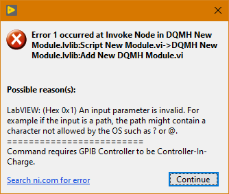

I am just getting started using DQMH. I receive the following error at the end of running the scripts to create a new module. However, my modules seem to function properly. Any ideas as to why I am getting the error?

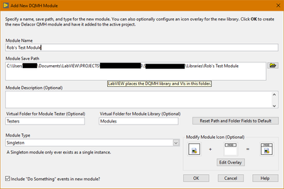

I am installing a built-in Singleton module using the method exactly described in all the videos (see screen captures below). I am using LabVIEW 2019 SP1 f5. I am using the latest release of the DQMH (6.1.0.90). I am adding the module to an existing project. Not sure whether that matters or not.

Thanks for the additional info. If you create a new blank project and try to create a module in there, do you still see the error? I'm guessing you won't, which means there's something in your existing project that is causing an issue.
Are there any auto-populating folders in your project?
If you create new virtual folders (like 'testModule' and 'testTester'), and specify in the New Module dialog that you want your module library and tester to go into those virtual folders, do you still see the error? I ask because those fields in the dialog are new in DQMH 6.1, so I'd like to know if they are the cause of the problem.
Message 4 of 11
(3,094 Views)
So, your suspicions I think are correct...I did not get the error when I created the module in a new blank project. No, there are not any auto-populating folders in my existing project. When I created new virtual folders (testModule and testTester) and specified the new module library and tester go into those virtual folders I did not get an error when added to my existing project. So, there is something about the default virtual folders (Testers and Modules)?

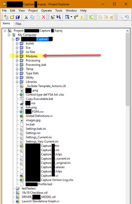

The Modules directory is highlighted in yellow with the red arrow pointing to it in the screen capture below:

Accepted by topic author Worred
That's an auto-populating folder, and explains why the error is happening. I think the fix should be that the New Module tool shouldn't try to move a module/tester into a folder that is auto-populating, even if its name matches the name specified in the dialog.
