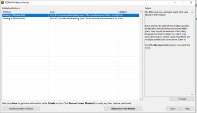

I'm relatively new to DQMH and ran into an issue when validating an "Analog In" module that I created.  When running the validation, I am seeing 2 issues: "Error 43 occurred while testing issue "Non-reentrant even VIs in module"" and "Error 43 occurred while testing issues "VIs in module with automatic error handling"".  When selecting these issues, no VIs pop up in the details sections of the validation results windows to "fix the issue".  Additionally, Error 43 seems to be related to opening/creating/replacing a file VI and is most common when the path for said VI doesnt exist.  I have validated several modules in my current project and the only one that I am seeing these 2 issues with is my Analog In module.  My LV Project file doesn't have any unexpected dependencies (only those in vi.lib) so I am not sure what files would cause this issue.  Below is an image of the validation results to show what the window looks like.  If wanted, I can post the module.

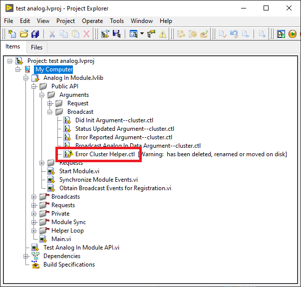

The problem is happening because of this missing VI in the module:
If you remove that missing VI, the DQMH Validation tests will no longer return an error.
The validation tool should be handling this error better. I'll make sure the DQMH Consortium knows about this issue and addresses it in a future DQMH release.

Well I'll be damned, I am missing that...  That must have been when I was trying to create an error handling VI like the MHL for my helper loop.  I went to try and find callers and subVIs for that control and nothing popped up.  When I went to load my Main.vi, there were no broken arrows, so I assumed that everything was on the up and up.
I can validate my module now, thank you sir!
