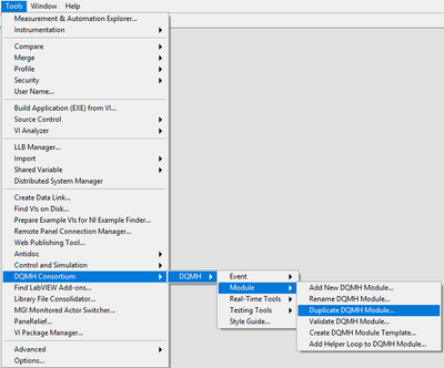

Since you're using DQMH 7.1, I think you should use the Duplicate DQMH Module tool instead of trying to Save As yourself.

Thanks for the suggestion. I haven't used the Duplicate Module functionality yet, but will keep it in mind the next time I need to do something similar.
