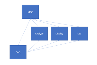

Here's another potential confusion I have related to someone else's writing about DQMH. Sam Taggert (https://blog.sasworkshops.com/simple-dqmh-dos-donts/) recommends in the section titled "Do be very cognizant of coupling" that all modules be arranged in a tree, and that broadcasts only go up the tree and requests go down. In his scheme, if you have a main with DAQ, Analyze, Display, and Log modules, could DAQ, for example, message the other three directly, or would DAQ have to  have to message the Main Module, and then Main would message the other three. Or perhaps I am not understanding what the tree structure would be in this case.
If you have such a tree, with Main up top, and all the other modules listed below it, then yes, DAQ would have to message Main first, and then Main would then distribute this info to the other modules as required.  So Main is acting as a message broker of sorts.
If performance is more important, you could make the Analyze/Display/Log modules be dependent on the DAQ module and therefore they could receive the broadcasts from DAQ directly.
