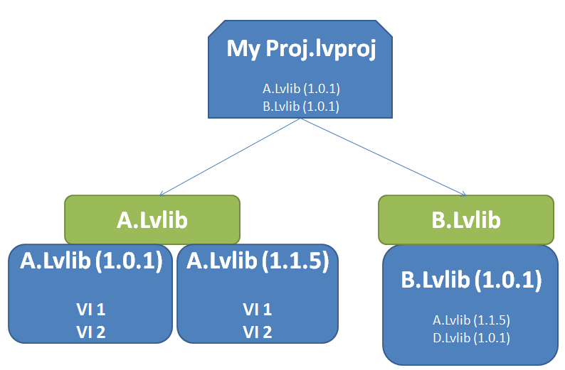

This basically brought me to the same thing LabBEAN suggested, which seems to be similar to the .NET manifest. The reason I quoted what you said above is that I think that libraries actually might be best suited for this, since they're already namespaced and versioned.
So here's a crude example. For this to work, I want you to ignore VIPM for the moment and just think about LV:
What we see here is that project VIs call VIs from A 1.0.1 and VIs in B.lvlib call VIs from A 1.1.5.
Here are some thoughts on this:
  1. LV will need to have a mechanism for recognizing that a library has multiple versions and where the code for each version is. That mechanism will be in the library.
  2. The linking to a VI in the library will not be to the actual VI, but to the library and to the fully qualified name of the VI. The linking will include the version number of the library.
  3. As you can see in the image, each component selects one version of the library, but different components can select different versions of the libraries. This allows you to create a library and know that it will keep working with the same version of the library it depends on, even though someone else is working on another version in parallel.
  4. Note that in this example, both the project and the library will need a dialog like the one LabBEAN refered to, where they will need to specify which version of the library they want to use. The best thing about this is that switching to another version of the library is as simple as opening that dialog (or right clicking the dependent library) and selecting "use version X". This is basically the same as the manifest files.
  5. Because the linking is to the library and not the actual file, this will allow LV to immediately change the linking for all callers to the correct VIs, as long as the VI names don't change. This also gives you static linking to the VI, so as far as the end user is concerned nothing changed - you double click a VI in the diagram and LV automatically opens the correct VI. I think that's an important point.
  6. One problem is with what I refered to as "components" which hold the versions of the dependencies. I used projects and libraries here as these components, but this becomes an issue if you open a VI not in a project or if you have a VI which is not a member of a library. One suggestion I can make is adding this dependency data to VIs as well. If a VI is in a library, the library data overrides it.
  7. Likewise, if a VI which is not in a library is opened in a project which has different version information, I can see two options -
    The simpler one is to dictate that all naked VIs in a project must have the same version and to display a conflict resolution dialog when opening the VI.
    The second is not to include the dependncy version data in the project at all. The problem with this is that if you want to modify the dependency for naked VIs, you have to do it for each VI separately.
This was a bit stream of consciousness, so I hope it's clear and that it doesn't repeat too much what has gone before (it has been quite a long thread).

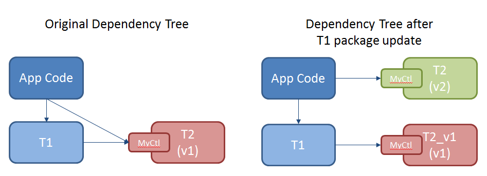

1.  The typedefs from the dependency trickle up to my componenet's interfaces, and some of those typedefs changed while keeping their names.
I've been thinking more about your problem.  As I understand it, you have a tier 2 conflict but you own and control the source code of the tier 1 component.  In many cases that situation can be resolved using Michael's suggestion of rebuilding your T1 package and making the T2 package from NI a private dependency.  When you install the new T1 package VIPM also installs the T2 package, putting it in a new location with a new namespace, and linking all your T1 vis to the "private" T2 installation.  That's how I think it works anyway... I haven't used private package dependencies.
In your case, it wouldn't work as well because you are using T2 elements in your application code, and the application code wouldn't know the original T2.lvlib has been moved and renamed something else.  You'd still need to go into all your applications that use your component and redirect the links to the new private copy.  (I'd make sure T2 (v2) is not installed when doing that.)  It's not ideal, but it sounds to me like a more manageable solution than either,
(A) remaining dependent on the older package and suffering version conflicts when I put my component into any project that uses the newer one, or (B) spending a lot of nights and weekends to refactor my component and test it with the new dependency.
At least this allows you to solve the problem incrementally, which is the most we can hope for given the current state of the technology and best practices.  Still, if the license doesn't allow redistributing modified code or you didn't own the T1 package source I think you'd be stuck.
