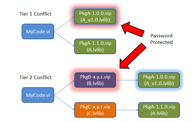

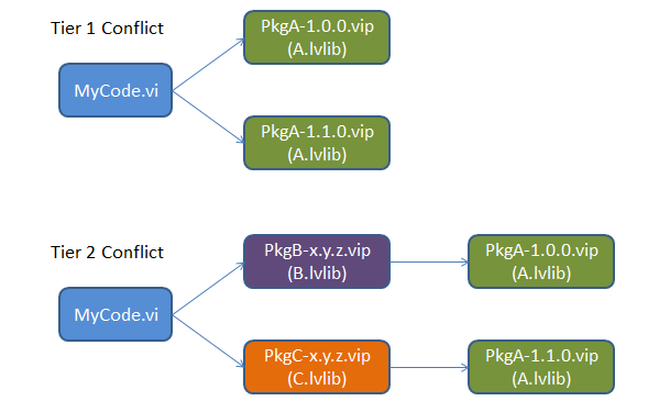

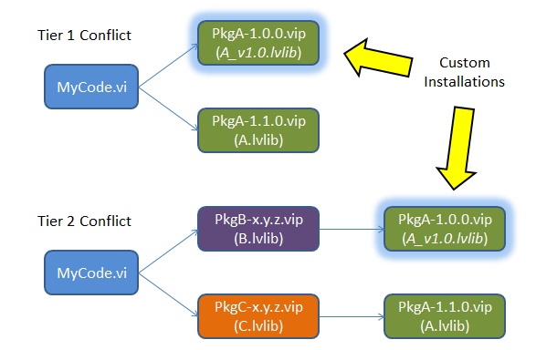

Here's another way to look at the situation as it exists right now, along with (of course) some new terminology.
In a tier 1 conflict, MyCode depends on incompatible package versions. The standard solution to resolving a tier 1 conflict is to change MyCode.vi so it uses the same package version. In theory it works. In practice it is not always feasible. A tier 2 conflict is where MyCode has dependencies that in turn depend on incompatible package versions. There is no standard solution to this problem.
Previously (way back yesterday) I thought the custom sxs model was flexible enough to allow developers to overcome any conflicts they might encounter. For example, many times the conflicts in the diagram above can be resolved by doing a custom installation for PkgA-1.0.0.vip, as shown below. The diagram shows the system state after a user installed PkgA-1.0.0.vip with a customized namespace and install point. It could take some effort to relink the source code to the custom installation, but tools would be developed to help with that.
Today I'm not sure the custom sxs model is sufficient. In particular, what happens if a package's source code is password protected?
I did some playing around with a series of password protected classes. As long as you can isolate the linked libraries in their own app context I'm fairly sure it's possible for end users to manipulate the linkages regardless of password protection. A few brief tests with the LV linker convinced me I don't understand it well enough to claim the custom sxs model is always sufficient to resolve conflicts. Even if the custom sxs model can solve the problem, it looks to be a huge headache for anyone who is forced to go down that path with more than one or two dependencies.
At this point I'm thinking the standard sxs model is the only solution that gives us a workable solution.
