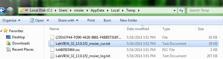

Sorry, these messages keep getting stripped of text because my replies default to the HTML editor without me realizing it.  The file is under:
C:\users\<username>\appdata\local\temp\ and the filename will look similar to the following:
Message 7 of 10

I thinc I found these file(s):
LabVIEW_32_13.0f2_ofinodeyev_log.txt
and
LabVIEW_32_13.0f2_ofinodeyev_cur.txt
