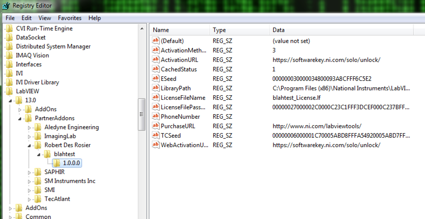

The German version of LabVIEW should not cause any issue.  Unfortunately, the 2011 build of LabVIEW will not have the LV2P debugging statements as they were added in LabVIEW 2012.  Which add-on are you trying to activate?  Do you receive an error when opening an example VI for the add-on?  If so, what error? Can you verify the license file exists for this add-on in the registry and on disk?   Registry for Win7 x64: HKEY_LOCAL_MACHINE\SOFTWARE\Wow6432Node\National Instruments\LabVIEW\13.0\PartnerAddons  License files: c:\programdata\National Instruments\partners\  In the registry and on disk there will be a folder/token for the partner product.

License exists both on disk and in the registry.
We tried to run "RegisterAddon.exe" as administrator, but it hasn't changed anything.
Log file from RegisterAddon shows that registration was ok.
Any more tips? It's a little bit curcial for us to get it running, otherwise we can not really use the toolkit...

Could you email your log file and a screen capture of your registry entries to us at labviewpartnerprogram@ni.com?

I send a log and screenshots to the address provided.
