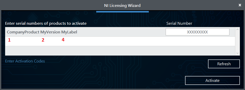

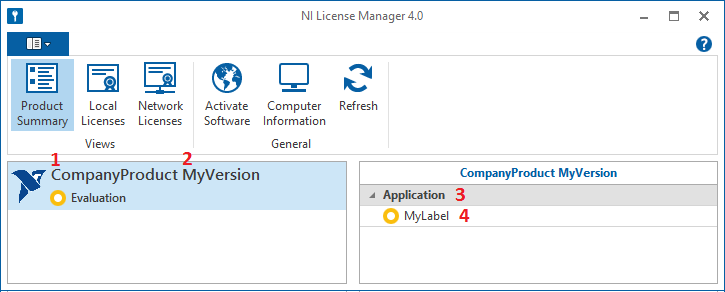

In order to use the NI License Manager SDK for your product, you first need to obtain a license file.  To obtain this, you must contact the NI Tools Network team with the following information:
  • Company Name
  • Product Name (1)
    • This is the top level name shown in NI license Manager
  • Version (2 - Only shown if no Display Version set)
    • Format: xx.xx.xx
    • This is the technical version number, but you may change the display version at a later time
  • Display Version (2 - Optional)
    • Free-form text
    • If a display version is set, this will show instead of the technical version
  • Type (3)
    • Application or Add-on
  • Label (4)
    • This is the second level name shown in NI License Manager
    • Some recommended labels are:
      • Base
      • Standard
      • Development System
      • Toolkit
      • etc
