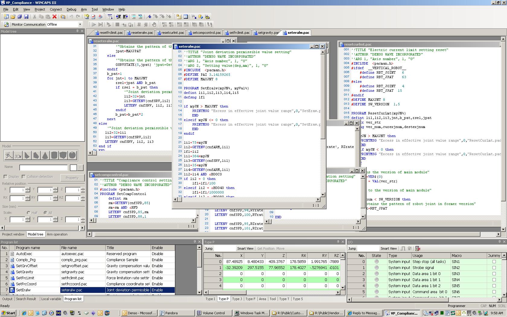

Pehaps you can clarify.  The Denso is capable of what is called 'current limiting' functions; this equates to compliance control (sometimes called soft servo, or force control).  This allows the Denso to set, as a numeric value, a maximum allowable force applied on any combination of axies.  The result is the robot will use only xx% of its power to insert a part (or whatever the operation is), and the arm becomes 'pliable' at its joints.  However, there is no direct translation to tell the robot that, 1kgF is the desired max force for a move; we can only use a % of the max current draw per axis.  These are libraries built into the Denso.
See the referenced libraries in my Denso code below.
To my knowledge, they are not currently directly accessiable via LabVIEW.  However, you can have LabVIEW run a program resident in the Denso controller, and that program can contain all force/compliance control related moves; then end and return programming control back to the primary LabVIEW program.  Also, some of the compliance control/force control is accomplished simply be setting parameters in the Denso, which I belive there is already a VI in place to get/set those parameter values.
