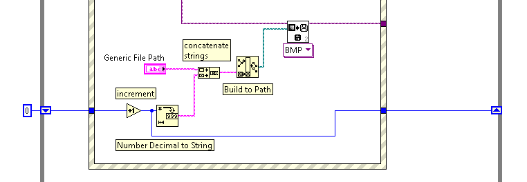

I can see why the Grab and Set Attributes example is a bit difficult for you to decipher. It is a rather complex VI that uses several features that you may not be accustomed to, such as Event Structures and Case Structures. This VI will grab an image every time the 'grab' button is pressed. So, if you want to save each image when it is grabbed, you would need to add an IMAQ Write File 2 VI (Functions Palette>>Vision and Motion>>Vision Utilities>>Files) to the end of the 'grab' event on the block diagram. Obviously, unless you wish to overwrite the file each time you grab a picture you will need to change the 'filepath' input. To do this, you can either prompt the user with a file dialog or add the number of times this event has executed to the filepath (see below).
FilePrompt.PNG               ...or...
