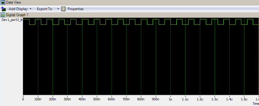

Hi Kevin, and all other NI Engineers out there:
Thank you for your detailed reply. Most of your answers matched my inferences so that was good. As I "promised" 🙂 , I am going to post some really interesting results and figures in this post. I have done many runs and many cases, and reading the post may require time and attention or else it may be confusing. Most or all of these issues are with regards to the recorded waveforms.
So here it is:
Desktop Config: Intel Celeron, 4GB RAM, 64 bit System, Windows 7. ( Its Celeron, not Core i7, sorry for mistake in first post).   This desktop only has Signal Express running. Nothing else.
Software: SignalExpress 2011
NI DAQ mx: Latest 5.2 version.
DAQ Card: NI PCIe 6537.
Voltage: 2.5V peak-peak. 1.25V DC offset. (SO its 0V to 2.5V swing)
Voltage Family: 3.3V
Prepare Data for Viewing: After Logging.
Sampling mode Continuous.

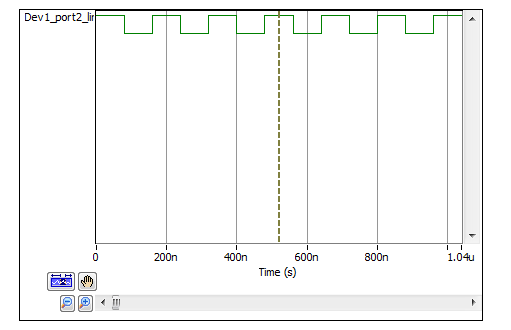

Case 1: (OK)
Input Square Wave of 6.25MHz. Duty Cycle: 50%
Sampling rate: 12.6MHz;
Samples to Read 12.6M
Clock Type: Internal.
Trigger: <None>
Result: Duty Cycle is as expected (Visually)

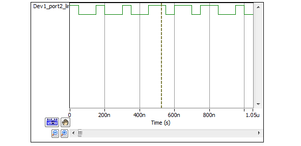

 Case 2: (Issue: Higher Sampling Rate)
All same as Case 1, except:
Sampling rate: 20MHz;
Samples to Read 20M
Result: Duty Cycle incorrect! I thought oversampling should not be an issue. Sampling theorem cannot be wrong. 🙂
Please explain.
Case 3, Case 4: Same experiments were repeated with an external clock(Active edge: Rising) of 12.6M and 20M on PFI-5. Same results observed.
Trigger: <PFI5 Rising Digital Edge.
Now experiment changes, more rigid requirements. Clock has to be 25Mhz(External) , and Data has to be 12.5Mhz. Duty Cycles of data: 25%, 50%, 75%.
Case 1: (OK) 50% DC
Input Square Wave of 12.5MHz. Duty Cycle: 50%
Sampling rate: 25MHz;
Samples to Read 25M
Clock Type: External PFI5, Active Edge:Rising
Trigger: Digital Edge, Rising,PFI5

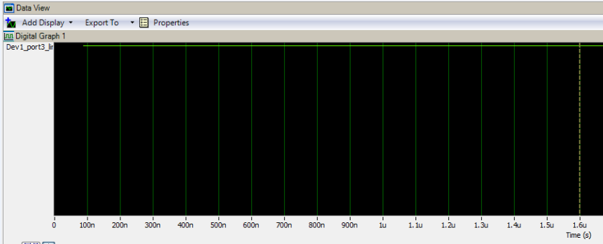

Case 2: (Issue 25% DC)
Everything else same.
Duty Cycle: 25%
Result: DC 0 Volts. (Low)

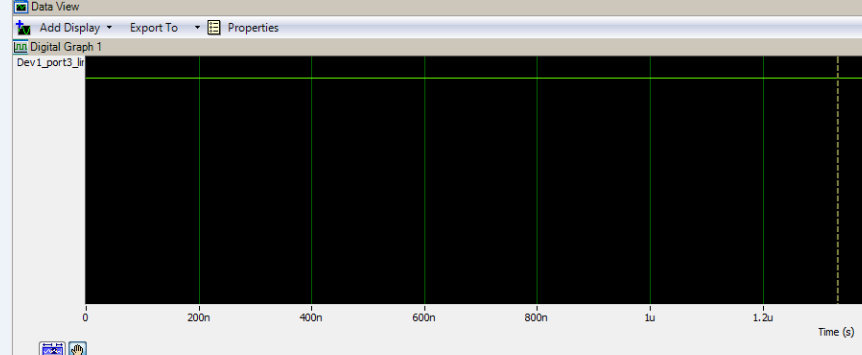

Case 3: (Issue 75% DC)
Duty Cycle: 75%
Result: DC 2.5 Volt. (High)

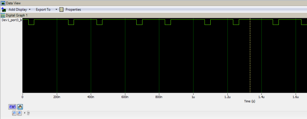

This is very confusing because Clock is exactly twice the data, still its giving me a straight line. In my real application I cannot increase it beyond 25M. But for now I increased the Agilent Signal Generator to 30MHz, hoping to get a better waveform, but here is what I saw. Even 50% does not work now.
Case 1: (Issue) 50% DC
Sampling rate: 30MHz;
Samples to Read 30M
Result: Duty Cycle non-uniform.

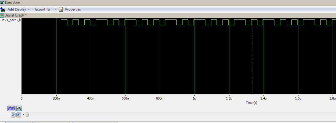

Case 2: (Issue) 25% DC
Everything same.
Duty Cycle: 25%
Case 3: (Issue) 75% DC
Everything same.
Duty Cycle: 75%
ASCII output:    111111 0 1111 0 111111 0 1111 0    (Obviously not 75% )
Now someone please explain all of this, or better still some NI DAQ Expert's opinion is most welcome.
I have tried 'n' combinations of Sampling rate, Internal, External, Sample Clock, Phase matching etc etc and almost all I can do with Signal Express. Its sad that such a basic data acquisition is being so unpredictable.
Signal Generators are working on a real-time scope.
Please Help as soon as possible.
Thanks.

I have a few thoughts for you that I hope will be useful - The on board clock of the 6537 is running at 400MHz, so at least for internal clock sources, that sets your time resolution (2.5ns).  So when you set your clock to 12.6MHz, the driver is going to round to the closest available frequency (12.5MHz). I think that is probably why the 6.25MHz signal looked so nice.  Maybe the external clock is being monitored and responded to by the card at 400MHz clock, explaining why the external clock behaved the same.
The same problem happens when you are sampling a 6.25MHz signal at 20MHz - you don't have an integral number of samples per signal cycle (20/6.25 = 3.2).  Also changing the duty cycle is effectively adding higher frequency signals into your 6.25MHz signal - you'll need to increase the sample rate if you want to accurately catch the time of the rising/falling edges.  The 6537 reads and writes on the rising edge of the clock, so you'll need a clock edge at the right time to catch your signal change.
For data compression, can you pack bits in signal express?  Instead of saving your data as 8bit values (I think thats what you're doing based on your file size numbers) can you shift and pack into U32 or something similar?  RLE could help if you're expecting infrequent changes in signal too.
Message 8 of 9
(6,743 Views)
Hi gharris,
Thanks a lot !
The "non multiple of 2" sampling rate is the issue. So if the sampling rate is2x, 4x, 6x, 8x etc, the duty cycle is maintained, but something like 3x is giving wrong results obviously.
It was so easy to overlook that one.
And yes, for the duty cycle too, a 25% duty cycle of 12.5Mhz will no longer sample at 25Mhz. I just drew it on a whiteboard, and got the answer, and 50Mhz sample rate for 25% DC works good.
Even though I cannot use a clock of more than 25Mhz, I think most questions are resolved now.
